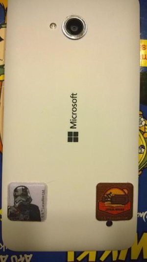

My first fix for this was two narrow strips of clear tape (3 layers) on bottom edges.
Fix v2 is a bit more visible ;) Ring around camera lens (for magnetic lenses) helps keep fingers out of the lense.
