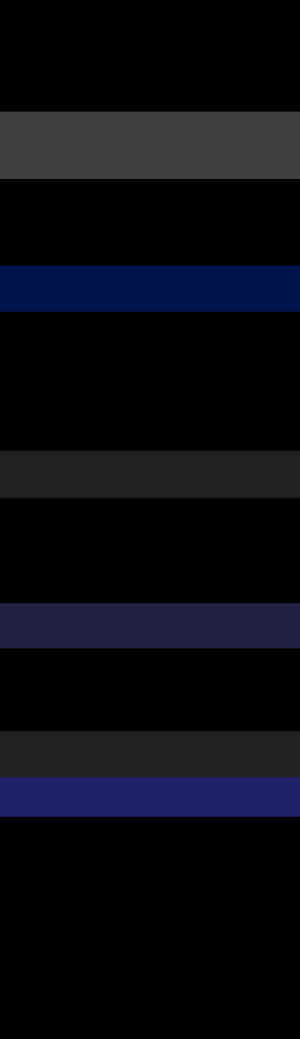

I found another problem with display on lumia 950 XL - smearing when scrolling dark gray elements/options mainly on low brightness in dark room. The gray will kind of turn a lil' bit purple/blue or something like that.
For example here is test picture:
Set brightness to 15% or so, go to dark room an scroll that picture to see if you got same problem.
Have I defect display or its normal?

Hi. And have you this problem too?
In dark room set brightness to 15% or so and open something with gray background (setting have gray bg)
picture left is 15% right 100%
yes, I used the very first picture you attached (the one with the horizontal bars all zoomed in) and I can definitely confirm it does the same on my 950xl as well

is this occurring only with low luminosity?
ok I can confirm using the picture you posted at the beginning in a dark room and lowering luminosity I can see the smearing
It is purple on the grey bars
raising luminosity or turning on the lights makes it much more difficult to spot (even though it's still there now that I pay attention)

I tested smearing. That does exist only on the EDGE of the gray while scrolling. And that's because it uses the diamond pentile arrangement of pixels. In fact if it wasn't for the ultra high pixel density you would be seeing the purples and colours around text and other stuff. You may be able to see it if you use a magnifying glass just on the edges of text without even having to have to scroll. It's designed so amoled lasts longer but isn't noticeable for the most part. But the scrolling of that picture may make it noticeable because of the brightness and interval it refreshes at.
This is an image from the Galaxy S6 edge which uses a similar display. Upclose chrome logo. You'll notice the colouring around the gray, though it's not noticeable with the eye due to high amount of pixels.
As far as the Gray's looking green, I don't have that issue. I tested it on the "standard" colour profile and my advanced one. So that one I can't really replicate. I'm on the latest firmware and latest redstone build.
