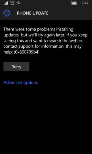

Getting 0x800705b4 error while trying to update my Lumia 620 from 10.0.10512.1000 to 10.0.10536.1000, there is also 10.0.10514.0 in the list. I don`t want to go back on 8.1 because I have apps installed that no longer publishes into Windows Phone marketplace. This phone is for tests only, my main device now is Lumia 640 DS LTE so it has no SIM and SD Card. Phone has ~2.5 GB free space. Tried reboot, 100% charge, removing Edge cache (is there a way to open Internet Explorer?), Maps data, can`t delete Search data because when I`m tapping Search button, Edge opens with Yandex page.

updating from 10512 on both phones :(wp_ss_20150916_0001.png
Got the same problem .. I haven't found a solution yet..
