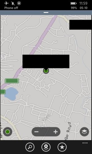

i dont know how to explain this anymore ....
see the green dot ? that means GPS is locked on !
i have offline here maps
and the phone is in flight mode (no wifi)
