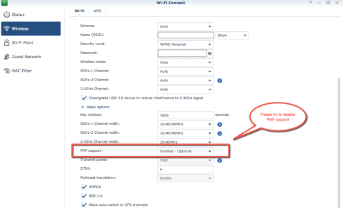

Got it working - Synology support responded with the following:
After our developer's checking, 2017 Surface Pro's Wi-Fi chip and 802.11r may have weak compatibility.
If the Surface Pro needs to use 802.11r protocol, please go to Wi-Fi Connect > Wireless > try disabling the PMF Support and check if this issue still exists.
Disabling PMF resulted in the Surface Pro connecting without problems while 802.11r remains enabled.
I'm on Synology Router manager SRM 1.2-7742 Update 4
