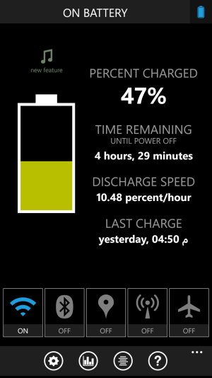

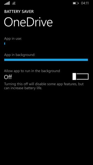

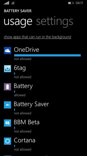

I made a mistake today by updating OneDrive app to the latest version 4.2.1
now it works all the time in the background using 100% of the phone resources. I tried to delete it or sign out from it but failed. sign out of my live account in the phone is not possible and soft reset will fix it in the first 10 min only. Not my biggest pain yet but My pain is how MS still keeps those trashy programmers after all these failures? it pains me a lot really.
any help to fix it other than hard reset or giving up using WP? I'll appreciate it
Lumia 930, without any other phone update.
check screenshots

Stop it running in the background from Battery Saver... Problem solved...
Did you check the screenshots?
Already is not working in the background and it's off. Also there is nothing in the app task progress upload/download. It works after 5-10 min of connecting to wifi.

Today I did soft reset 10 time and the wifi was off the whole day after a full recharge. The battery consumed only 3% in 8 hours which is great. Turning on wifi ignites the drain. There is no way to sign out of OneDrive to make sure of this problem. For 3 hours now, OneDrive isn't showing in the battery usage but the phone is warm even when not in use. Turning wifi off is my best solution. We use very smart phones which must turning off everything to not having these problems.
