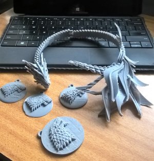

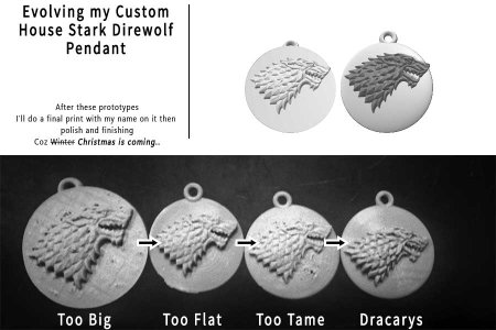

To start, here's my daenery's dragon necklace and assorted stark pendant prototypes in PLA. The necklace stl I got from thingiverse. I designed the pendants myself. I'm not much of a designer though. They're a bit hairy because I haven't adjusted the temp and retraction correctly. I haven't completely removed the supports yet either. It took a combined 18 hours to print the necklace, the pendants each took 30 minutes.
The necklace was from this.

I like what you did though. Very cool.

Those pendants are looking quite good. What software did you use to make them?

Only 1 of those pendants will become a gift this december. The rest will go the way of Game of Thrones and be killed off.
