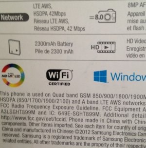

I put an ad up on kijiji and I've had people email me that it works and some say it doesn't. One person sent me a picture of the side of the box and it had written on it 'hsdpa (850/1700/1900/2100)'. I'm not sure which carrier it was originally from.

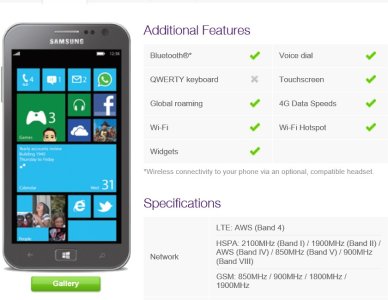

Well let's look at a couple things first.

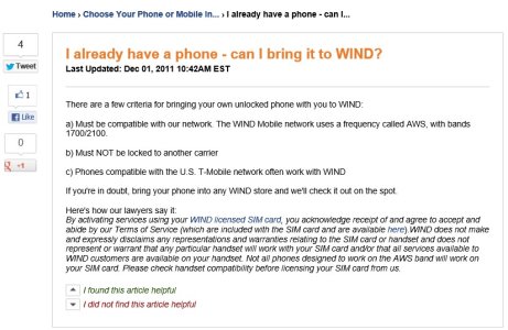

A quick look at the specifications which are from the Telus site but should be the same in Canada. As a side note the "AWS (Band IV)" is the 1700MHz frequency. Now we have a look at winds site.
wind uses AWS/1700 MHz/BandIV which as you can see this phone supports.So judging by all of this support material I would believe it to work.

The photo near the top of the thread has all of the network specifications, but I'll type it out since the image sort of cuts it off.
Quad band GSM 850/900/1800/1900MHz,
Quad band HSDPA 850/1700/1900/2100MHz
A band LTE AWS (another user said that this also means Band IV), though WIND doesn't use LTE as of yet.
