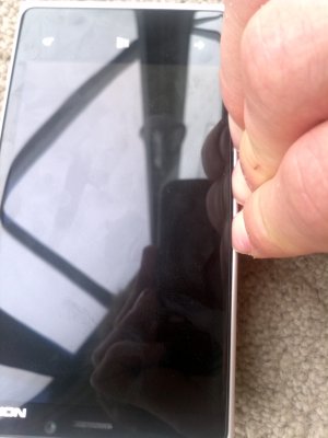

I also don't like that there is a gap between the bezel and the polycarb case, seems a good way for dust to get into the internals and under the screen. One side of my phone has a noticeable gap between the bezel and I can fit my fingernails and pull the case away from the body whilst the other sides of the phone are glued to the case and there are no gaps. When I press on that side of the phone it makes a popping/creaking sound as I push the gap closed. I don't believe this should be normal, as it seems like my display is separating with the body. All other sides are completely glued together.I did not notice this when I first got the phone and there was no creaking/popping noises upon putting pressure on the case.
Here's what I mean. Zoom in at my fingers and you can see the large gap.
