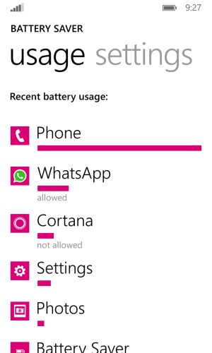

Hi...
After installing 8.1, battery is draining too fast in my L920, before 8.1 getting battery for whole day but after 8.1 before evening battery is dying with similar usage pattern.
All background process disabled except Whatsapp, Wifi is on for all day. No background synching.
Cortana, Glance, Double tap wkup, Bluetooth, NFC, MobileData everything is Off. Brightness kept in low state. Even when screen is off, battery is keep drying % by %.
Im not getting why phone functionality consuming that much battery?
Is any one facing this problem? Any solution?

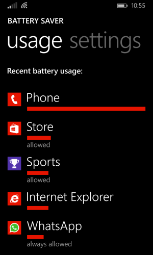

I have same issue and an almost similar screenshot from battery saver usage:
I haven't changed my phone calling pattern at all and I usually barely make any gsm phone calls so really don't understand how the phone app can be using all this battery ?!
also, whatspp seems to show that most of its battery drain is when using the app versus background usage which also seems to be illogical. I do get lots of whatsapp messages (background) but I reply pretty quick and then close the app.

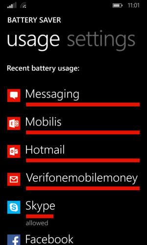

Now after a soft reset my battery usage looks even sillier !! There seems to be a real bug in hoe this is calculated because there is no way for messaging yo be at the very top !!
