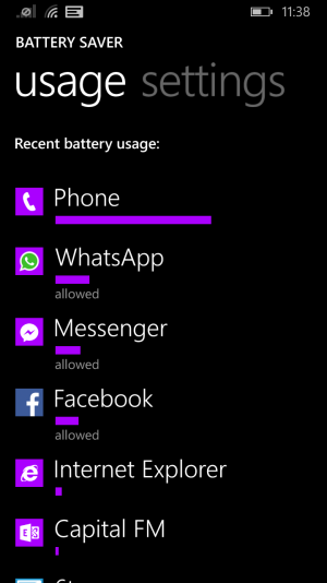

I'm having the same problem. I hardly make any phone calls, yet the battery usage for Phone is ridiculous! Let's hope the HTC firmware fixes it.
