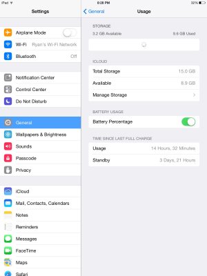

That doesn't really tell me what I'm looking for. I'm looking for something like

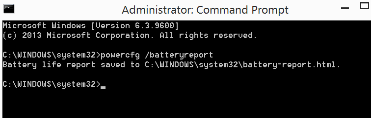

If you open an elevated command prompt and type in "powercfg /batteryreport" it will save an html document somewhere. In my case C:\WINDOWS\system32\batteryrepot.html.
(You have to move it out of the system folder to view it.) When you open it you will find very detail info on your battery status. You can also replace /batteryreport with sleepstudy to find info about the sleep habits. Not the most user friendly or easily aceesible but the in formation is great.
