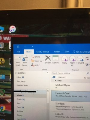

I'm noticing an odd issue with my SB, I don't recall seeing this occur before, so its seemingly a recent phenomenon
When I use Chrome, OneNote, or Outlook, a black box appears behind the main window, it more or less flickers based on my mouse movements and/or typing. Not every app causes this and typing doesn't always cause it to appear, though using the mouse seems to be the main factor.
I ran the sfc /scannow cmd and I set the performance setting to maximize performance. I've run malwarebytes (just to be safe) and uninstalled a bunch of stuff that could have been a potential cause, i.e., I had adguard installed but in the name of finding the cause, I uninstalled that.
Here's a snapshot of what I'm talkng about
I'm using the default theme, and I tried changing themes, no change, I also uninstalled flash - again no improvement
Interesting, I just changed the resolution to the native setting, it was at at a lower setting, and I wonder if I was making my iGPU work harder with the scaling required.
I have the base model surfacebook which does not have the dGPU. I'll keep monitoring the situatiuon but at the moment, the resolution changed seemed to fix it
