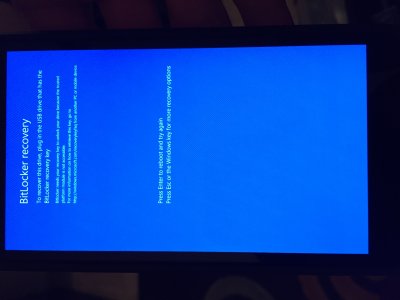

I was at dinner tonight and my phone was just sitting on the table and out of nowhere rebooted to a blue screen with a frown face. I have no idea how to fix this. A soft reset didn't help and the Windows Device Recovery Tool doesn't notice the phone. Anyone else have this issue?

Before I got my refurbished replacement 950 from AT&T mine did this:
I had to take it to my local Microsoft Store. They hooked it up to the device recovery thing and, after many false starts and resets, were finally able to get it working again, though it took more than an hour. They'd never seen this before nor were they certain how to correct it, but they managed to make things right!
I just completed this process on the 950 that I am currently using. It is a bit of PITA, and took a little time, but it was recoverable.
