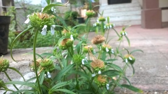

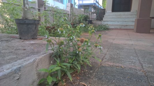

I kept a space of 10cm and tapped at the flowers, it showed focus lock too but the result was this.
AdobePhotoshopExpress_2e4f78acb2074153bd1c75c48193fbdb.jpgWP_20160322_16_45_04_Pro (3)-001.jpg
These were taken with the Lumia 520, how can take such pics with the 1520? Without any lens additions
