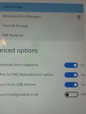

I have attached some pictures of my settings. I tried multiple flash drives, the latest being a new out of box USB 3.0 flash drive. I'm pretty much out of ideas really...any help is appreciated. The drives were formatted to FAT32, secureboot is off, etc... Can anyone suggest any other ideas?

Thank you for the follow up. Unfortunately, I am still unable to boot from the USB. I have now tried several flash drives and imaging methods including ImageUSB. I even tried different .iso files for 2 different forms of Linux and no new result.
Another update for anyone who might have more advice. I decided just to test things out and run my USB recovery media for Windows from boot and see if that works and it works immediately. Not sure if the system is rejecting it because it's not Windows or what, but I've tried several different versions of Linux OS as well as different methods of imaging the OS to the drive. This makes me think it has to be somehow related to the OS/how it's put on the drive, but I'm not certain.
