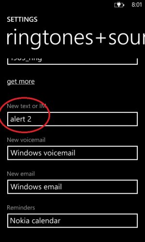

You need Black w/GDR3 to use custom tones for SMS, IM etc. And copying them to the phone's ringtone folder is the correct location NOT to SD card. You could store them on SD but you then need http://www.windowsphone.com/en-us/store/app/ringtone-maker/5a99cbd9-e82a-4892-8264-17a64f9142e5 to make them a ringtone
Also what file format, MP3, MIDI, WMA etc. and how big is a file, less than 1000KB ?
and in SETTINGS ringtones+sounds does it have this option listed where you can choose?

As I allready mentioned, I allready have the black update, and all app updates...
No matter, I allready solved the issue, and it was indeed as you said.
I deleted them all on the SD, and copied them again to the ringtone folder on the phone, this time they went through.
