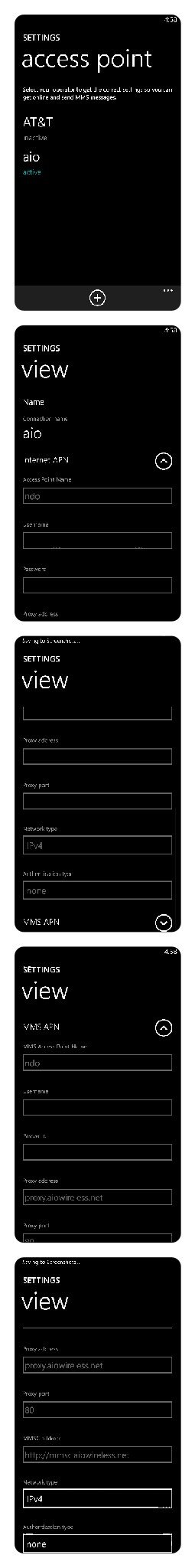

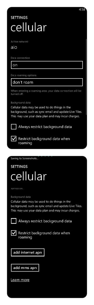

Alright! I've figured it out. I used my aio lumia620 to find out the correct settings. I was having issues with my ATT Nokia Lumia 1520 that I use on AIO wireless.
First step is to make sure to uninstall network+ if you have it already. If you need to uninstall, change the date/time manually to something like 3/31/2130. Then go back to network+ in settings and it will ask you to uninstall because it is expired. After you're done turn the date+time to set automatically.
I didn't change anything under cellular settings. I used the "access point" settings and added AIO with the following settings.
Then follow the following pictures I took.

What following settings? I don't see anything in your post. I'm not sure if you using a Lumia 1520 (assuming ATT branded) makes a difference compared to using a Verizon branded 822, but I'll give it a shot if you can post the settings you used.
