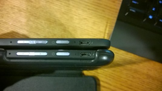

I have two DV8 Pros, a 64 and a 32. I noticed that the chargers were oriented opposite.
The 32 is on top. After a few months the 32 quit charging. From anything. I got it fixed under warranty. They replaced the motherboard. When I got it back I noticed the motherboard was oriented the other direction. They must have changed the design at some point.
