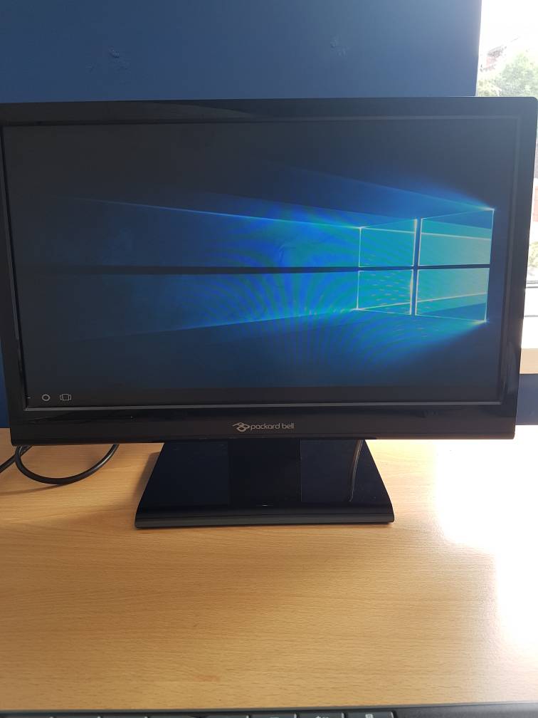

I'm one step better with the new adapter, the monitor now picks up a signal.
However the content displayed is too wide and I can't get it to fit the screen (screenshot attached).
I've tried adjusting all options on the monitor itself, but nothing helped.
I've tried changing the connected display settings on the 950, but nothing has helped there either.
The monitor is 1366 x 768, does that have anything to do with it?
Also, I never got a Continuum setup message where it plays an intro video and gives the opportunity to adjust the screen if it's not fit properly. Is there anyway to force that to happen? I've tried reset app, but the option is greyed out.
Any help gratefully received 😊.
I believe 1080p is the max for the phone on an external screen. If you can't find a control to tweak it on your monitor you are going to have trouble. Sort of surprised there isn't a way.
So, I sent adapter number 2 back for a refund.
I ordered a HDMI adapter yesterday (which arrived today), to instead connect the phone up to my main TV rather than the old VGA monitor. I had to change a setting deep within the TV menu to get Continuum to fit to screen, but finally I've got it to display properly on a screen .
The adapter is a multi adapter with a USB 3.0 port, USB-C port and HDMI port. I have a wireless mouse and keyboard, which have a USB receiver which I put into the USB 3.0 port of the adapter and I plugged the phone charger into the USB-C port. Mouse/keyboard worked perfectly with Continuum and the phone was being charged - so adapter is working well.
