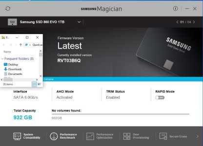

Well, this was a surprise the SSD arrive today instead of tommorrow.

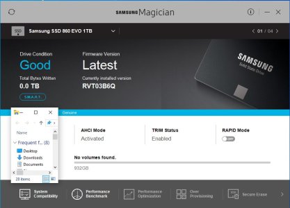

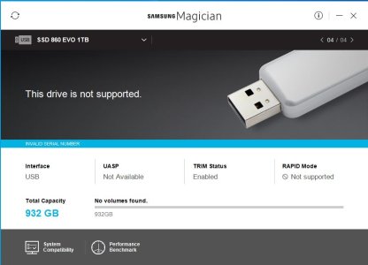

Samsung has really borked the Samsung magician software it seems, I plugged it into an external usb 2.0 adapter and had a brief scare when the magician software reported the SSD was not genuine :grincry::grincry:.
After plugging in the SSD directly to the motherboard using Sata cables etc:
The software detected it just fine.
But... the borked software followed and infected one of the trusty tools anyone should have - Rufus (Portable) as the latest version creates two partitions on the USB stick - one for UEFI and the other for Legacy boots. After using version 2.11 off my Laptop, the o/s installed just fine.

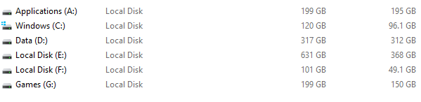

After a quick analysis, I decided to the split the drive as follows:
The local disk entries is the spare mechanical hdd I was using - in the process of migrating my data over as I did a clean install.

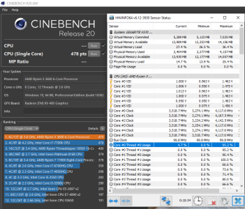

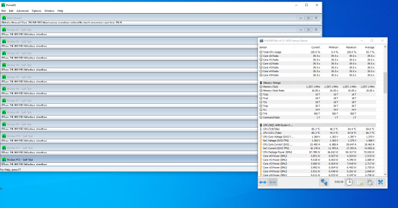

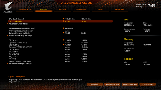

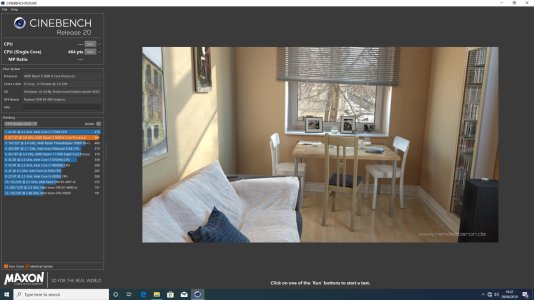

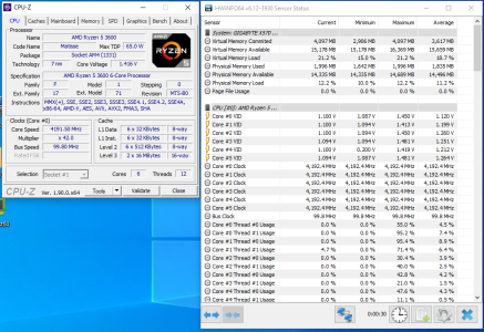

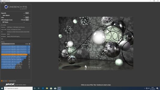

Update: after spending almost two days testing here the highs and lows in summary.
NB: All temps are in degrees celsius. Hwinfo set a sensor refresh of 100Mhz. Each Benchmark was run at least 5 times in quick succession.
First the bad news.

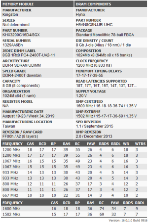

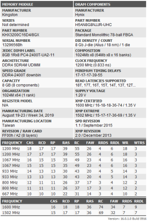

1) The Hyper X Kit - HyperX HX432C16PB3K2/16 Predator DDR4 16 GB (Kit 2 x 8 GB), 3200 MHz CL16
Was easy to get to the 3200 Mhz via the loaded profile. However it had ridiculous number of memory errors at 16-18-18-36 set via XMP or manually set in Memtest86 (bootable usb). I thought it was the crucial ssd (the dead ssd, I sort of revived by completely wiping it out). But it worked fine at 17-17-17-39 no matter what I threw at it.
Taiphoon Burner (freeware) confirmed my suspicions, unfortunately I put too much faith in the ram and spent hours testing / trying to find the cause of the random crashes. As memtest when ran in the windows environment. I was only able to over clock to 3333 Mhz and no more. So much of the screenshots didn't even save... when it first happened I was perplexed.
So it's going back to Amazon for a refund.

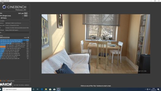

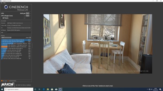

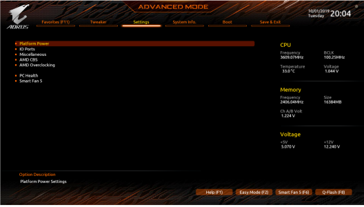

2) There are stories going around on the interwebs about the boost issues with the 3rd gen chips and can attest that they are true. As I was never able to get beyond 4117.6 Mhz sustained single core boost with either the latest bios update (f5b - 1.0.03 ABBA) and stock bios (f3 - 1.0.0.3 doesn't Gigabyte doesn't specify variant) both run a variant of the Agesa 1.0.0.3 update.
I got blips of 4217 Mhz after any benchmark ended with the ABBA update but not sustained. No matter what I tweaked I couldn't get the cpu to sustain it, so AMD seriously needs to fix the bios and chipset drivers.
I was in two minds about sending the CPU back, but it just kept bugging me to no end and the fact the R7 2700X is now the same price what I paid for the R5 3600 (£192.98) that price drop sealed it for me - it's going back this weekend as the R7 2700X (£193.98) arrives tomorrow.

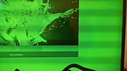

3) The motherboard, my biggest gripe about the Aorus X570 elite motherboard is that it had no power off / reset button on the board. Also the toggles sometimes toggle between 0, Manual and Auto for some settings. Plus I didn't find the use of page up and page down intuitive as I prefer to use them scroll up a page and down a page But you can use the plus / minus keys to toggle instead.
The chipset drivers on Gigabytes website... oh boy... here's a little taster when installing them:
However!
The drivers from AMD's website work just fine and none of the rainbow effect malarkey when installing them.

The CPU, the Ryzen 3600 is a nifty performer I was able to achieve 4.3 Ghz all core over clock albeit not stable using the wraith stock cooler with about circa 20 degrees celsius ambient temp. The Cooler Master H500M Case was out of stock on amazon when i bought the components (I'm not paying over £200 for a case no matter how good it is lol). I do plan to make my own case but I just don't have the time for that project.
This screenshot is taken by the screen shot function in the bios, pretty darn nifty as it saves people seeing my ugly mug in the reflection of the screen LOL!
I was however able to get 4192 Mhz all core boot but given my ram issues I don't know if it was the stock cooler, the ram or if it wasn't stable under max load as it crashed under Prime 95. As I was able to use the PC for over ten minutes installing benchmarks and extracting files with no issues and I was getting random crashes when running benchmarks even at stock. But the oddest thing is that memtest never showed any errors, the only errors it would show is to say ram was locked by xyz programme.
Never the less this CPU is a beast and this next screenshot shows why it beats the 3600X from a value proposition. With all cores overclocked with 39.50 x 100mhz multiplier it pulled 95 Watts under Prime 95.
In terms of benchmarking performances, I found no discernable difference between the F5b and F3 bios as all variations fell within the margin of error.
This screenshot is with the F5b bios, all stock settings and XMP for 3200 Mhz as that is what the ran is rated to run at - out of the box it runs at 2400Mhz.
This screenshot is with the F3 Bios and everything stock + xmp 3200.
The above results are reproduceable hence one screenshot.
Here is the multicore benchmarks with the stock F3 bios.
As you can see there are quite alot of deviations which are reproduceable.
To be continued in next post.
Edit: Derp, I saved some file names with PBO instead of PB, precision boost overdrive was not used. As it's off by default when load optimised defaults is used.

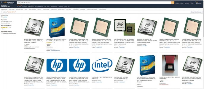

Even with the variances, this nifty little CPU beats out a 12core/24thread Xeon e5-2697!
Which is still being sold crazy prices...
2) The ram... I've got nothing to good say about the ram other than I was able to boot to desktop with 15-17-8-21 Timings.

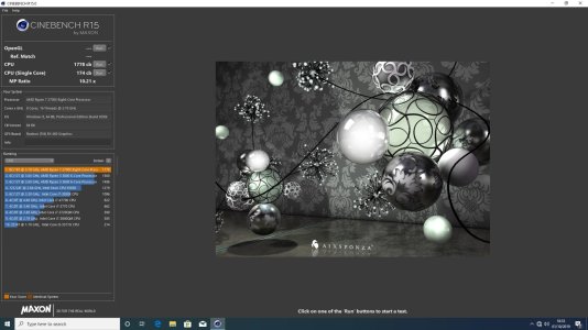

Also my R7 2700X arrive today and interestingly the R5 3600 beats it in single core benchmarks. All stock settings in the bios, the same bios used (f3), just the XMP of 3200 used as it was used for benchmarking the R5 3600 to get the ram up to the advertised speed.
It obviously is leaps and bounds ahead in multicore performance:
Also there are settings that are disabled on 2700X in the bios - which are enabled on the R5 3600. Initially I thought I borked the bios update as I updated to the F5B bios to do some additional quick testing on the R7 - that CPU locking mechanism for the bundled cooler is a pain in the rear end to remove.
Settings screen from R5 3600:
Settings screen from R7 2700X:
