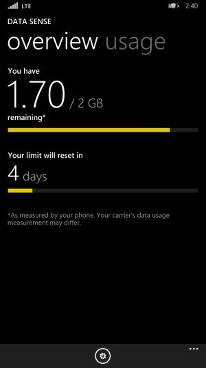

I have been using Data Sense on my ATT 1520 since upgrading to 8.1 on 4/15. It seems to work accurately. I cannot explain how or why but I will take a screenshot:
The 940 is the version with AT&T's hardware and software tweaks. One of those software tweaks is to remove Data Sense. If you install the Developer Preview of 8.1, you'll have Data Sense because it's part of the standard OS. However, when you upgrade to the released version, you'll lose it again since AT&T doesn't put Data Sense in the OS image for their phones.
