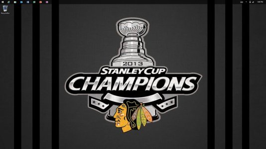

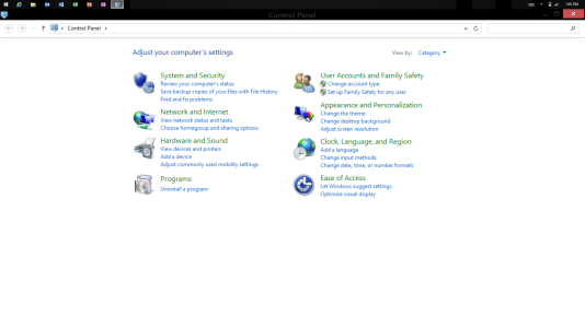

When I opened my Surface 2 after it being off the charger for 5 hours, it was at 56% and really warm. I went to the desktop to check the battery but I noticed the whole desktop toolbar was smaller than normal. I went to the control panel and noticed that the wording in the control panel window is really blurry. I haven't done anything to my Surface since last night. I checked the updates and there was only Windows Defender. Anyone know how to fix this issue? Here are the screen shots I took

You may have the Taskbar set to use small icons. Right click on the Taskbar, then click Properties. Untick "Use small taskbar buttons" if it is ticked.
the blurry might be caused by scaling. since everything on a 10.6 inch 1080P at 100% will be very tiny, Microsoft set the default scaling to 150%. but if the programs aren't written with scaling in mind (like device manager) they'll look blurry.
also do you have other PCs on this Microsoft Account? if the settings for the task bar are changed on another computer it'll sync with your surface.

My laptop is running 8. Not, 8.1, so I don't think it would sync. I haven't changed any setting either.
Have you checked the setting for using small icons on the Taskbar and the scaling settings, what are they set to? Do you have "Let me choose one scaling level for all my displays" ticked in the Display settings?

Thanks guys. Some how my settings on my scaling were set to the smallest. I don't know how since I never changed it. But it's fixed now!
