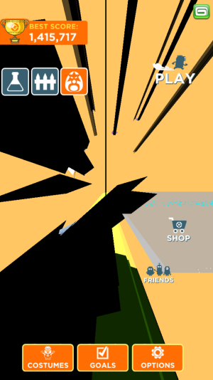

Hi there, Ryan!
I decided to download Minion Rush to see if any new content packs had yet been released for the Windows Phone platform (the Moon, for example). When I installed the game, it did find my cloud-based gamestate and replaced the local (new) gamestate on my phone successfully. I then connected Minion Rush to my Facebook profile and saw my list of friends and their status in the game. When I returned to the main menu, the entire interface became graphically glitched out in a way that is eerily similar to what had been happening on my Lumia 2520 Windows RT tablet a while back.
It is probably worth noting that I am running the Preview for Developers build of Windows Phone 8.1 on my Lumia 1520.
Thanks,
Brent
That's weird! Not sure if it's the preview build that's causing the issue or not. I'll need to check and see. It is worth noting that the Moon mini-game along with the Anti-Villain League environment will be coming to Windows in May. We recently made the announcement on our social media channels and I can't remember if I posted about it on WPCentral in one of the threads I'm active in.
It only seems to happen if I visit the "friends" portion of the game. If I just go into the store and then the game or just launch the game, there are no problems. Very strange.
