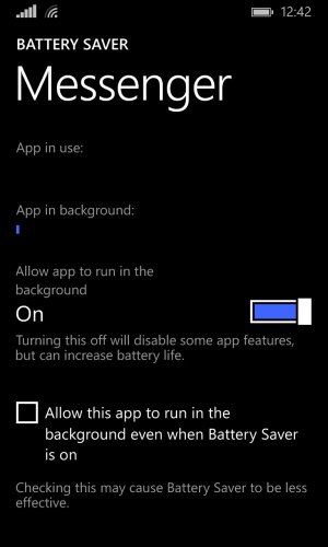

I'm wondering why you're even having an option for background tasks for the messenger app, as this has apparently been removed in the latest update. oO When I go to battery sense, swipe over to applications and tap on the messenger, it doesn't have any options at all.
The option is still there in Battery Saver, though:
