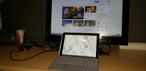

Does the Continuum dock work with the Surface Go?
Yes, it was launched for the Lumia 950 but it'd be great if it's usb-c connectivity allowed me to make use of the dock's USB and HDMI ports.
Thanks in advance for any help.
I haven't tested it but it worked with SB2 so it should work, but I doubt it will keep up for charging....
I've tested it now and works and even charges the device....or at least it keeps it at 100%
Keep in mind that it only supports external monitors at 1920x1080...
Ability to charge will of course depend on what/how many USB devices you have plugged into the dock. But yeah, the Go works very nicely with the dock. I'm glad the dock isn't just a one-trick pony for the Lumia 950.
Based on this thread I have bought the Microsoft HD-500 Docking Station for 950/950 XL as I want to connect my Go to my tv and connect USB devices, thanks for the info.
