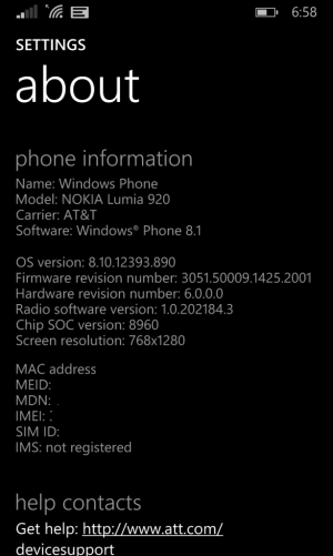

My device is a Lumia 920. I have the official Cyan and 8.1 updates. I am not using the Developers Preview 8.1 or 8.1.1.
I have had Cyan for 3 days now and I hate everything about this update. I want to go back to Black. I have already tried using the Nokia Software Recovery Tool. That did not work. It told me that the only update that was available was the one that's already installed. I have also tried using the "rest your phone" option under about in the settings, and my phone still has Cyan on it. Is there a way to do this that I have not already tried?

What do you hate? Just curious. Any issues should be cleaned out by a hard reset.

Basically what everyone hates, no more support for Facebook from the messaging hub. I'm also not too fond of the video playback on IE either.
The hard reset just set my phone to a clean install with Cyan still installed. It did not restore it back to 8.0

A hard reset will never clear out firmware. Once applied, everything has been overwritten so it is not possible to restore to the way you bought it via hard reset.
You'll need to use Nokia Care Suite and the Data Package Manager to download the exact firmware you want, then flash to your phone. There are several guides to doing this scattered around the forums. I had never flashed a WP before, but just last night I did... Pretty easy, though the frustrating part is setting up the proper tools and dealing with other misc problems that pop up from time to time (For me at least, grrr)
I think this is your only option at this point. Good luck!

Not gonna lie, the messaging hub messaging kinda sucked.
I'm sad it was ripped, but then again FB is really pushing their messenger.
but OK, if its worth losing the good bits as well, can't stop you, but you'll have to get the right ROM to flash I think since your phone model is already officially upgraded if I understand right.
