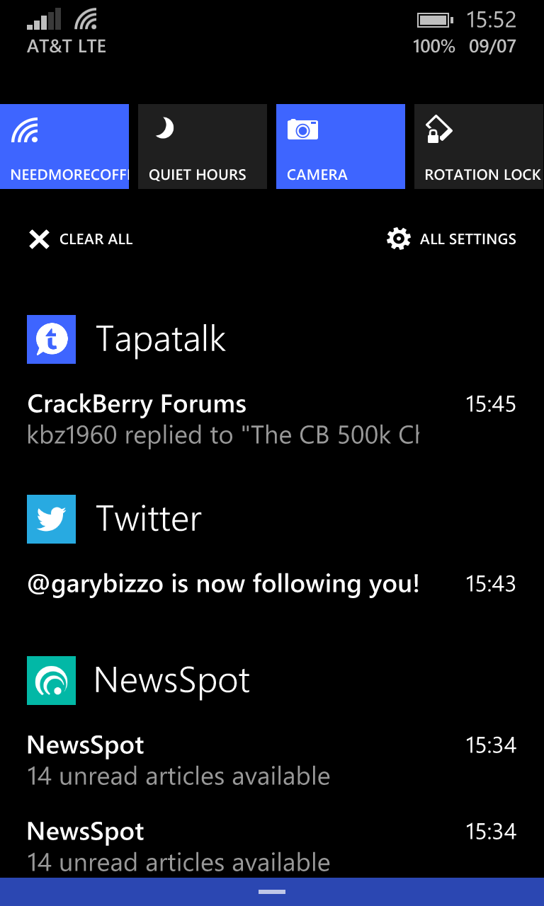

Has anyone noticed that twitter notifications are always duplicated in the action center? Before the most recent update it would happen frequent but not all the time, now after the last update every twitter notification is duplicated (see pic). I have uninstalled and reinstalled the app with no effect. Is this affecting anyone else?

Edit: Not sure but I may have found the issue. I disabled tweet notification in the app itself and the next notification in the action center wasnt duplicated. I'm guessing the duplication is due to the new integration in 8.1 pulling the notifications directly and turning it on in the app causes the same notification to be displayed twice.
It just occured to me to try this as I remembered I did get notifications after reinstalling the app but before actually signing in which I thought was odd but seems to back my theory.
Edit 2: Confirmed disabling the in app notifications fixed it, toggling it on and off shows its the source of the duplicates. Sorted! :)
