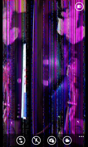

I have been using this Lumia 920 since November and have had no issues whatsoever up until tonight. I loaded up my camera and encountered this glitchy noise which I screenshotted:
It froze like that after about three or four seconds. I went back to the homescreen and started the camera once more and I get greyed out camera options and simply a black screen:
