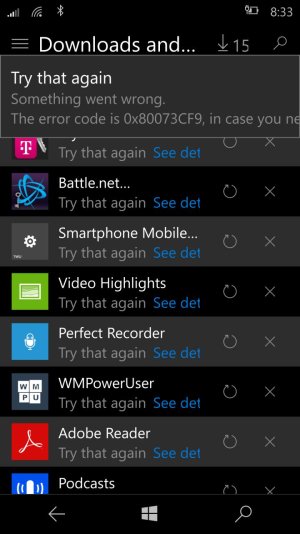

Have several apps that are giving this error. Does this just mean not compatible? Although shows in download list with "Needs Attention" shows in app list but clicking does nothing. Uninstall is geyed out. Don't see how can remove and reinstall.

hello, i have a similar problem,( insider fast ring, lumia 640 DS, build 14367) my default to install apps is on SD card and when i want to install "Gesture" and "Lumia motion Data", even if i accept to temporaly change the destination to the device or if i change the default destination i got the error 0x80073CF9.
Any clue to solve this problem?
i should say that this problem alreadey exists from about 2 or 3 months
Update : i took the SD card out, the defaults was then "this device", tried to install again "Lumia Motion Data" got installed but not "Gesture and Touch" with the same error message..

1 - Go to Settings, Storage, Device, App, search for that two and move to SD
2 - If you cannot see there, move to Storage, SD, App, search for them and move to Device
3 - if you cannot find anything, another way is sysapp pusher
4 - Last way, considerin that two, like Rate my device, are marginal core apps, wait till next upgrade. I'd never consider an hard reset for such of them.
All these apps are part of the settings and must be installed on the device, Rate my device and Lumia motion data have been finally installed on it in removing the sd card but i dont care about them, the only one i care about is "gesture and touch" .
I will try sysapp pusher
many thanks for the answer
UPDATE :
i did re-initialized the phone, restored my last backup, removed the apps on the SD card, re-installed all the apps from my MS ID, and everything works now...Dont know why but it works!!!
The problem about installing "Gestures and touch" was solved just moving the app "touch" from the SD to the Device, then I just updated "gestures and Touch" and it worked smoothly.
Seems to me some apps need to be in the same root to be installed as intended
No need to do a Hard Reset!
Make sure the application that you are updating is not listed in the apps list as "unavailable"
If it's there, uninstall it and then try to download again.
