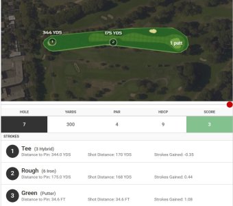

C. nash i will do my best to help you.
I have used the band 2 for golf 6 times over the pass month.
Great device but there is a little learning curve.
Once you start up the band the distances front middle back will appear(see first photo with myroundpro data)
For example Par 4 350 first hole
Say you hit a drive in the middle of the fairway when you reach your ball hit the action button.
This will recalculate your yardage to the pin.
Same method applies when you move to a new hole.
Once you reach hole #2 you will see a dash located where front middle back would be.
Hit the action button to calculate your yardages.
The process takes about 7 to 10 seconds to get yardage information.
Hope this helps.
Last image is a birdie i made yesterday at weequahic golf course in NJ
