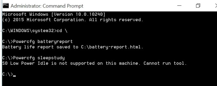

Everyone try running batteryreport and sleepstudy.
Open Admin command prompt.
Cd \
Powercfg batteryreport
Powercfg sleepstudy
Now go browse your C: drive and open the two HTML files.
Run those reports Dewg mentioned. They take all the guesswork away. For me the WiFi in sleep mode was going full tilt and burning more battery than when it was in use.
Ok, I did that and got low power.jpg and I have no idea what I'm looking for in the battery report.
Open up that html file in a web browser. It looks like it is in the root of the C drive.
What device do you have? Says the sleep study isn't supported.
I got the battery report, but I have no idea what I'm looking for. It is a Surface Pro.
