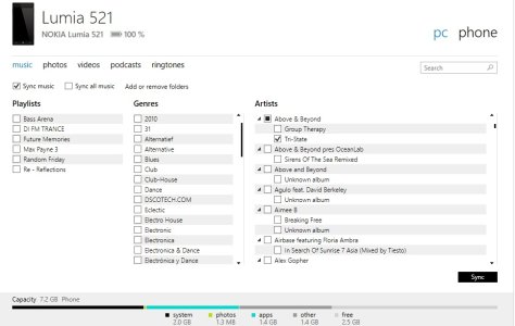

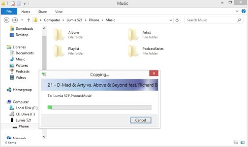

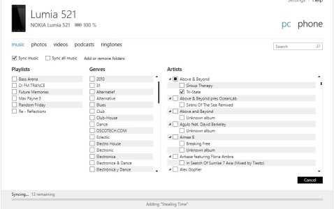

This is what happens all the time I have tried to sync one song with the file explorer and an album with the desktop app. Both of them don't actually sync. I waited approximately 15 mins for each of the sessions. Zune has never taken that long. Also When I went to the file explorer in the lumia it prompted me with an error message saying the phone is write protected. There is no SD card in it. I have tried deleting all the folders within the music folder and that doesn't work. It keeps saying its write protected or read only.
So I don't know what to do. The app that comes with windows and automatically detects the phone has the same sync problem but I will not post a screen shot of that.
Thank you for the help.

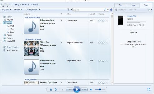

just use windows media player, on the top right click sync then drag whatever album you want to the sync pane and then click sync now, I never had a problem with it

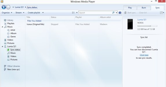

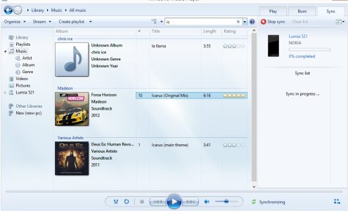

Windows media lumia issues 01.jpgWindows media lumia issues 02.jpgWindows media lumia issues 03.jpg
Still doesn't work. It tries to sync but fails. When I click to see results it says it stopped. Should I reset my phone?
