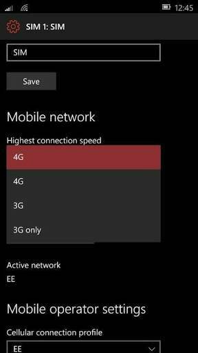

Is there anyone to help me in enabling 4g in my Lumia ,It is not showing 4g in settings and I am operate it on windows 10 .Please help
I have encountered this problem when using 2 SIM cards on a dual-SIM 950 XL. Both SIMs will received LTE if inserted separately, but they revert to 4G when both are inserted. Then when removing one of the SIMs, the AT&T SIM stays at 4G and will not connect to LTE. The only way I have found to fix the issue is to remove one of the cards and then move the AT&T SIM to the other slot and then reboot the phone.
I believe this is a software issue Microsoft never bothered to address. Both of my SIM cards are LTE capable. But when the 2nd one is inserted this issue appears. I do not know if this happens with every combination of 2 SIMs or with just some of them. The ones I use are AT&T and a Keepgo international data SIM.

Well that does make things confusing, especially the 950 XL normally displays LTE until I insert the 2nd international SIM. When the international SIM is inserted and used as the data SIM, it starts to display 4G (even though it is LTE capable).
>>In regards to your issue, only one sim can receive an active data connection as far I've heard. Unfortunately I don't have a dual sim phone to test and check for work arounds.<<
It is correct that when 2 SIMs are in place, one is specified as the data SIM, the other receives phone calls only at 2G. After that is done, the ATT SIM no longer displays LTE if I designate it as the data SIM. That's when it changes from LTE to 4G.But that is not really my issue. The issue appears after I remove the international SIM.
When the ATT SIM is the only one in the phone, it displays LTE. When I insert an international SIM into the 2nd slot, the ATT SIM reverts to 4G. When I remove the international SIM, the ATT SIM continues to display 4G and does not return to displaying LTE. A reboot does not cause it to return to displaying LTE. It does return to displaying LTE only if I switch slots and then reboot. This may not be significant at all in light of your information about carriers mislabeling signals, but since the phone displays both 4G and LTE as if they were different, it does indeed get confusing.
