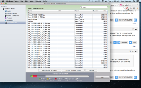

How is it that you do that? I don't see an option or a folder at all. Is this because I have a mac and have to use the windows phone app on the mac to sync the photos? Even when not auto syncing them, if I click on "browse device" only the individual files show up and none of them are larger than 2mb...

This is what it looks like when I try to sync, because I have to use this app since I have a mac. I see no photos with "high res" in the title... Screen Shot 2013-09-24 at 12.05.27 AM.png
