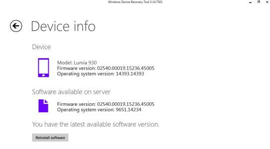

Depends on the phone, you can downgrade the L930 to WP8.1 using the Windows device recovery tool actually :).
Depending on your L930 variant you either get "full" denim update or the "half-baked" version.
Also you can use WDRT to flash roms obtained from https://www.lumiafirmware.com/
Download the relevant files and place them in the packages folder located:
C:\ProgramData\Microsoft\Packages\Products\RM-XXXX
For example: C:\ProgramData\Microsoft\Packages\Products\RM-1045.
But you have to block the internet access to WDRT prior to connecting your phone.
