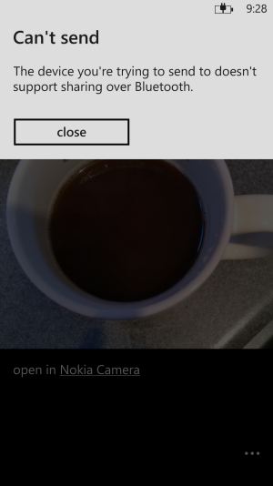

Has anyone been able to connect their ICON and Surface 2 via bluetooth? It will connected and then immediately disconnect.
Any suggestions?

I read a post that stated that it worked with the 2520 so I tried it with my Surface 2. No go so far.
I've never had any Windows phone establish and hold a BT connection with a Windows 8 device. It only seems to work when you use the taskbar icon to send or receive files or with the tethering feature in GDR3 and 8.1. Starring a connection via NFC also works for initiating a transfer but other than that it always pairs then disconnects.
What are you trying to do with it? Mine disconnects pretty quickly but if I right click on a file and"send to Bluetooth" it works. I assume its terminating the session because you aren't actually doing anything
I can't connect to my SP2, either. My Bluetooth mouse has no problems. I am just try to transfer photos.

To send files via Bluetooth, please do the following:
1. Open the Desktop app on your Surface.
2. Click on the Bluetooth icon in the bottom right corner.
3. Click on Receive a File.
4. On your Windows Phone, open the file you wish to send.
5. Click on Share.
6. Click on Bluetooth.

The reason they don't stay connected is because they both see each other as mobile devices. Mobile devices do not allow streaming to each other only file sharing. Accessing it through the desktop as suggested is the only way you will be able to transfer files.
