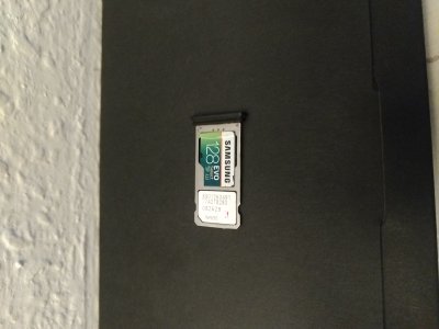

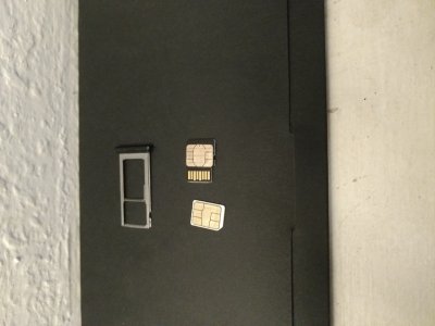

hi, sorry I tried checking the forums to see if anyone has done this, but I accomplished this and wanted share how.
I melted the plastic off the second sim card and super glued the sim to my sd card...
it works
Brave man to start melting plastic on an expensive device... so. Pictures of how you pulled it off? Went with the 950XL because I need two SIMs active. But if you can show how to do this I might go to Swappa right now.
I melted the chip from the plastic of the sim card and glued it to the sd card, carefully inserted it, wiggling it slightly while inserting it, and it worked

I went to the browser to post a few pics, looked like it post, but now in the app, I do not see them. are they uploaded?
Nice, so I don't have an X3 and haven't looked at that, but you may have just pushed me over to making the purchase. Nice trick, glad it worked.
i still played with my 950 because of that, and the micro SD card Still fits In the slot for the Lumia 950. And I only used enough glue that I can possibly take the SIM card off the SD card. If I need too.

That is creative. What did you use to melt the plastic around the 2nd sim card?
I used a lighter carefully, not getting to close held the chip on the edge of my box cutter, then carefully used the box cutter blade to pry the plastic off the chip
