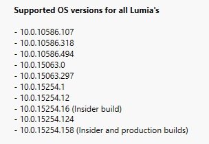

Hi, I don't know what SFTP is but I'll google it. I'll attach an image with the list of supported OS versions for root unlock listed on windows internals:
Mine is 10.0.15254.369 which is not listed. Maybe the last numbers don't matter much cause they refer to small patches and the core stuff of the os version is the same. I guess you could enlight me a little, I would not like to have to make a clean install (due to some **** up in this whole processes) cause now Instagram is dead and there's not an unsigned app yet to deploy nor revamped Project Astoria, I could use likegram but it's not as good. I could live without IG but if I can I'd like to keep the app on the phone.

Sorry I re-readed your previous comment and saw you mentioned SFTP, anyways, as I could understand I need my phone interop unlocked with vcreg to use it right? That's it :P sorry, but time has passed and forgot the details about your other reply.

Yes you need to have it unlocked with vcreg first. Install Interop Tools. Then enable it from Interop Tools. Find a SFTP client to use. I like using Swish, despite some its quirks it works just fine.
