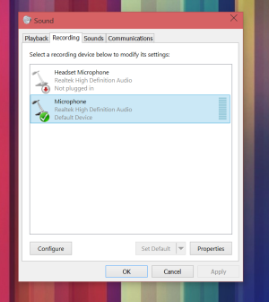

After getting my Surface Pro 3 all set up with build 9926, the first thing I did was enable "Hey Cortana". I immediately tried it. Nothing happened. A little bit louder. Still nothing. Frustrated I screamed at my computer and what do you know, success! This obviously won't do so if you are having a similar issue try this!
1. Right click on the speaker icon in the taskbar and select "Recording Devices".
2. Find you Microphone and select "Properties".

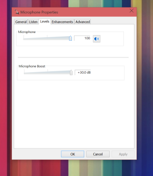

3. Go to the "Levels" Tab and increase the Mic Volume and Boost to where she can easily hear and understand you.

Yes, I discovered this tweak myself. I didn't have to use the boost, but turning the default volume up to 100% definitely helped.
