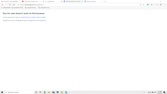

Hey Dani,
I am using the Edgeium browser(Chromium Edge:winktongue:) and noticed this(Check the screenshot attached). Can you answer this...?. After all, Edgeium is also based on chromium same as others mentioned in here.

There was an article about this. Google is checking the browser variable to basically see 'Is this edge', and if it is, blocking. Maybe someone can write an extension that spoofs, so the answer is 'this is chrome'.
But in answer to your question, yes google are being typical anticompetitive asshats, as per usual.
My understanding is that it's more of a whitelist, browsers that have been verified to work. "Is this Chrome? Is it FireFox? Are you Safari? OK, you're good to go."
Edge Chromium is new and not even officially released yet. It makes sense that it would not be on a whitelist yet. I have no idea about the current Edge though.
Isn't this what the user agent does? This feature has been built into browsers since like forever.
IDK. Can you change it right now in edge, so that it works? Can you make a webpage think that Chrome is Firefox?
Yes, that is exactly what a user agent does. Like I said, the ability to change the user agent has been built in to browsers for a long time. I thought everyone on this forum would know about them. It's quite basic. I'm surprised you're not familiar with them. Check it out.
You can do if from the console tool or a couple other ways...when there is no work around it is a lower level of code that you can't alter directly. I thought duo was almost dead anyway.

I've been through all this already and solved the issue. I even tipped of this site, but they never printed it.
Try again in Edge Chromium 76.0.152.0 and see if it works properly. For me it does, whereas sites like Google Meet in previous versions gave the same error message as in the original post.
Here's how I got around it:
1 - Install User Agent Switcher from the Chrome Web Store here
2 - Edit the Google Chrome Windows user agent string to be:
Mozilla/5.0 (Windows NT 10.0; Win64; x64) AppleWebKit/537.36 (KHTML, like Gecko) Chrome/73.0.3683.86 Safari/537.36
3 - Set the option inside the User Agent Switcher extension to remember the selected user agent at start-up.
