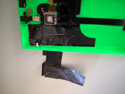

Here's the kicker - The phone I purchased 6 months ago was labeled '100% New, never opened, never used' and after taking the cover off it was clear I was sold a repaired unit. Battery Tape removed, back cover adhesive peeling and WATER INDICATOR TRIPPED. So, I'm pissed.WP_20170926_12_07_56_Pro.jpg
