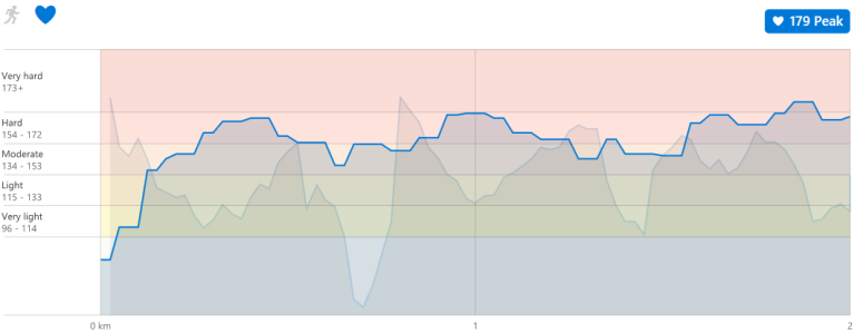

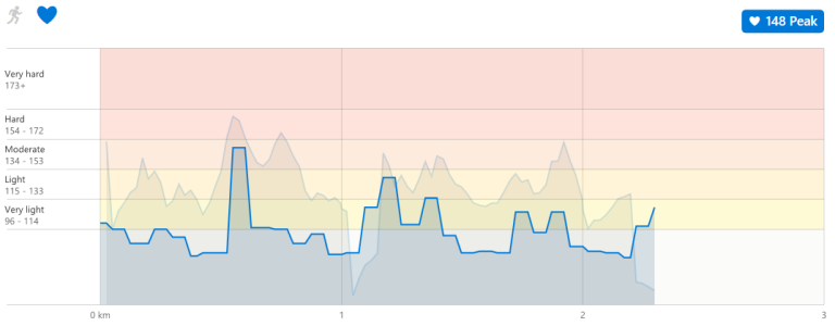

The lock is okay for most parts, and it even gets my HR properly at around 140 - 150 but after a minute or so, it drops down to 80 - 90 and stays there. After a while it loses the lock and has difficulty to gain it again. Please refer to the screenshots I took from the Dashboard site.
Microsoft Band 1 - Run
Microsoft Band 2 - Run

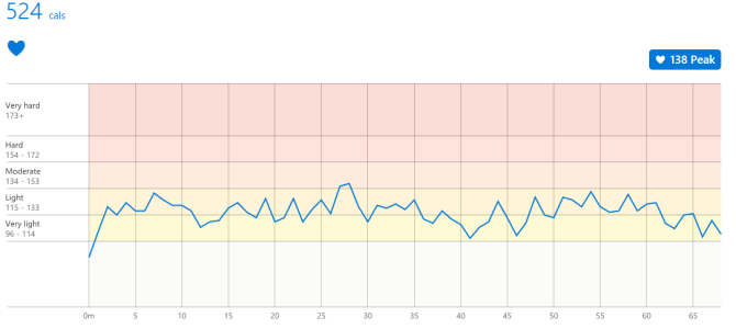

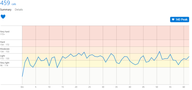

For comparison, I checked the Heartrate difference when doing my workout. Here are the results:
Microsoft Band 1 -Weight Lifting
Microsoft Band 2 - Weight Lifting
As you can see, the Band 2 seems not defective because it IS tracking the HR properly at higher rates, but I have no clue why it messes up on the crosstrainer. I think I will test it for 10 minutes on the treadmill just to check if my "grip" when holding the handles is causing any issues but I would doubt that.
For sleep tracking and day to day routine, everything works really well. Even regular workouts in form of weight lifting and stuff like that, it works perfectly. But for some odd reason, it messes up big time when I'm really pushing myself. And that is just frustrating because my heart feels like it would explode at any second and my Band 2 says "yeah, your heartrate is at smooth 85 - 90, so everything is cool."
Has anyone else problems like that? And if so, is there any fix for it?
I wear the Band 2 the same as my Band 1. Left hand, inside. Yes the optical heart rate sensor is now on the inside so I thought that may cause trouble. Swapped it to the right hand inside - no difference. Even put it back on my left hand but outside this time. Nearly no lock at all.
Like I said, I'm not sure that the sensor is defective because it CAN read properly, but decides to ignore nearly half of my pulse as if it could not see it properly. My Band 2 is the same size as the Band 1 which is Medium. I wear it in the last 3 or 4 clicks before it's not getting any tighter so it's not brutally tight. For working out, I usually put my Band 1 a single click tighter to make sure it would not wobble around and lose lock. Tried the same with the new Band. Doesn't matter - always locks down at around 90 when working out hard.
