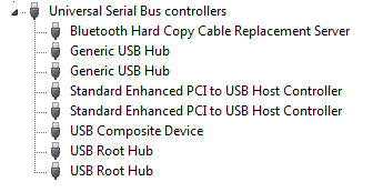

Hmm, I'm not sure which drivers correspond to what file in a PC, but what I can do is attach the following image containing the basic list of my drivers from my device manager:
