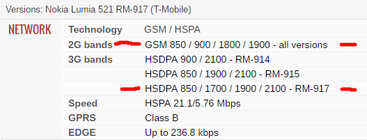

RumoredNow New member Nov 12, 2012 18,134 1 0 Apr 6, 2016 #14 re: Vishnu YV said: Airtel...India Click to expand... It would appear that even though the 521 has the right Frequencies on board, it is operating on the wrong Bands. In the US on T-Mobile, the 3G radio is tuned for AWS Band 4 which uplinks on 1700 and downlinks on 2100 MHz. Whereas Airtel India is looking for IMT Band 1 which uplinks on 1900 and downlinks on 2100 MHz. https://en.wikipedia.org/wiki/UMTS_frequency_bands#UMTS-FDD_Frequency_bands_and_channel_bandwidths I've got a question in on some chat channels about whether you can cross flash to a 520 ROM and get the radio you need...
