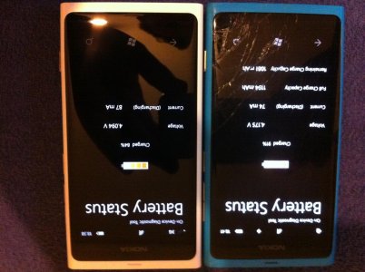

Recently purchased Lumia800 (white) vs old Lumia800(cyan)
Both devices feature the same firmware revision number .12220 but the hardware rev number is ....2.3 for Cyan and ....2.4 for the white one
Also battery lasts a lot longer on the white one than it use to last on the cyan one when new!!!
Any one any ideas why this info is hidden in the later build?
That cracked screen brought a tear to my eye. Also the picture is upside down :winktongue:

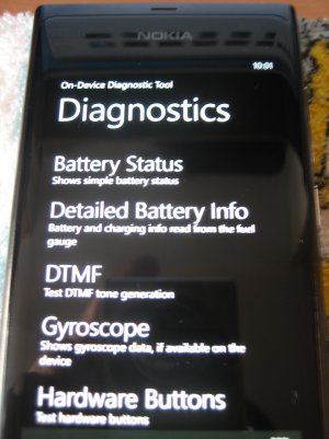

I am running firmware revision .12220 and hardware revision .2.3 on my Lumia 800. When I open the diagnostic tool, there is the battery status (simple view) and detailed battery info directly below that:

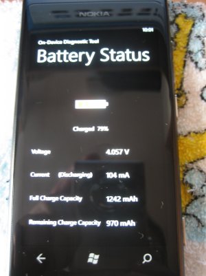

The simple battery status is shown in pic below:

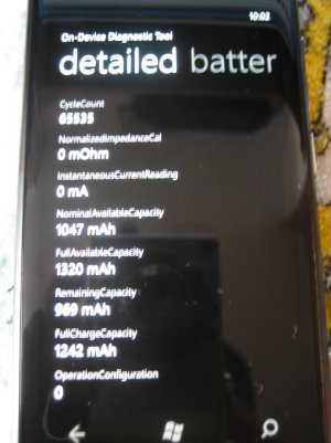

Now when I open the detailed battery info and swipe over to the detailed section, that missing info is there.
Sorry the pictures aren't as clear as I'd like, my camera wouldn't focus. Anyway, I hope that helps somewhat :wink:

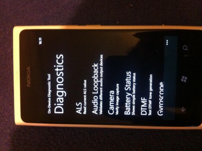

Hi, here is a snapshot of the white one. I never had detailed battery info, not even on the cyan one....hmmmm Both UK models bought from UK, not imported.
That looks cool, wish I had that info at hand. Thanks for you time
