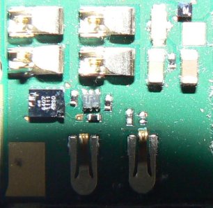

How did you determine this was the chip to replace? Here's my issue
  • Camera button and power button broken
  • Flex cable replaced, same problem
  • Hard reset, same problem
This chip you mentioned is identified in this picture here and the place that has the chip for sale says it is "IC for Wifi, Bluetooth signal regulation." not anything to do with the keys. A picture of
my chip is included and the numbers are different ... how can I safely get it off the PCB?
Yes you right, this is exactly my problem! Probably a mistake in the description on the website that sells this chip.
