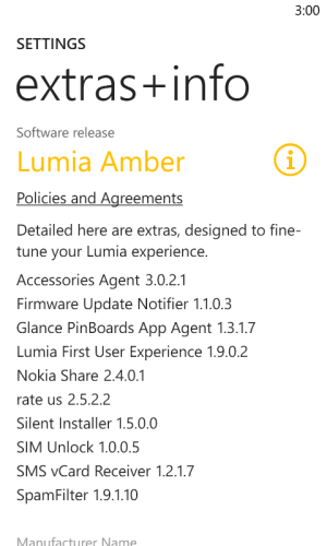

i know that it should be available for me, but every time i hit check for updates it keep saying i'm up to date! WP_20140629.png
i know that it should be available for me, but every time i hit check for updates it keep saying i'm up to date! View attachment 70501
Yeah, the extra and info sometimes need to be updated to show the latest os release from nokia e.g. Amber, balck etc
Thats why i told you to download the sys app pusher on the store.
That app can check system software update manually e.g extra and info, network+, etc
After you update the extra and info it should show nokia black
What he/she said ^^ plus can you post your OS and firmware version from the settings >> about section
