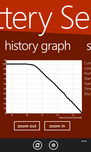

However as the graph above shows, power usage is sometimes excessive and there appears no obvious logic other than some process(es) is/are using a lot of CPU in the background sometime - you can tell because power drain is massive and the phone typically gets warm when this happens.
