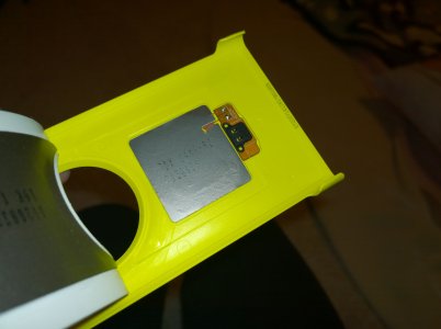

If your like me and own a 1020 I have to say that the 1020's wireless charger case is kind of unneeded. Coming from the Verizon Lumia 928 and having already bought 2 chargers I have already got to love wireless charging, but I just hate having another case on the device to just do it. When looking at the inside of the case you may notice that there is a "sticker" covering the whole inside. Now if you were to stick a x-acto in there and GENTLY pry the sticker away you will see this inside.
As you can tell the only thing inside there is the coil, there is no electronic components at all. So why no try to fit it inside the device?

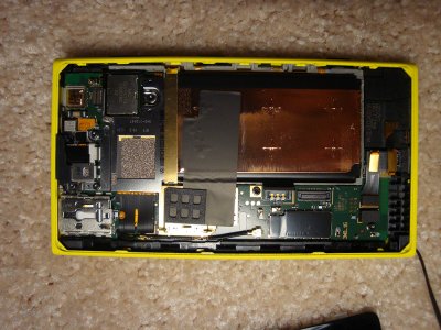

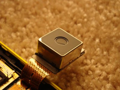

(might I say, this device is very easy to service) here is a pic of the inside and the amazing camera.
So to do what I did, you need to remove everything till you get to just the raw magnesium and ploycarb chassis. Remove the flex cable at the bottom that is used for the back cover CAREFULY.
1) From the cover remove the coil and the connector
2) De-solder the coil from the connector.
3) Solder the coil to the metal pins and you should get something like this.
Now I did a dirty deed and cut some the magnesium housing to help the charging. You may not have to.
4) Place the coil and the flex back into the device
Now it *should* start charging. This was not a 10 min adventure, this was a 4+ hour job to get it right! If it does not work the first time you may need to try it at a angle (not as shown bellow, that way really didn't work to well.

Due to the gigantic camera in the 1020 this causes the device to be at angle this could be why it is hard to get a good connection to the charger. Which is why Nokia did not include it onboard (IMO why did Nokia not just put a larger battery, include wireless charging and make the phone thicker).

That is an amazing picture. Wonder what the camera feels like to be on the other side of the shot ;)
